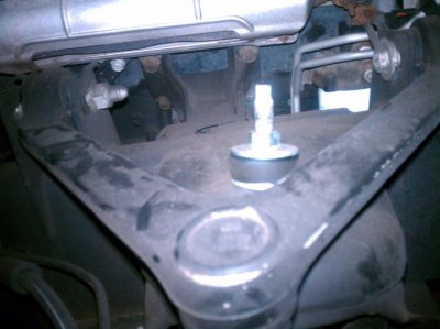

Ok, scratch my initial post. I did some more digging and learned that it's not the bottom mount that's moving. It's a clanking noise coming from the top half of the shock. I tried having my wife stand on the bumper and jump up and down to help me replicate the noise, but she doesn't weigh enough to make it happen :(
I am leaning towards needing new shocks....I think it might be trash.
Unrelated note....check the 2 attached pics out. Should that big metal piece that is welded to the lower control arm be rubbing against my spring? It makes a god-awful noise when they're rubbing together up and down. I don't know if I could even heat this piece up and try to bend it back to where it SHOULD be without it returning to this position again down the road.

You shouldn't have a prob with heating up the bracket and bending it out the way

UPDATE:
I figured out what the clanking noise was. The bolts on the top of the shock were SUPER loose. Tightened them down a few weeks ago and it all went away.
I noticed yesterday that the noise was back with a vengeance....ten times worse. It sounded like the front of the truck was going to fall apart. I stopped and looked at it....and I can grab the nuts and rod and move all of it up and down with my bare hand. Call me crazy, but a shock shouldn't do that unless it's busted all to hell.

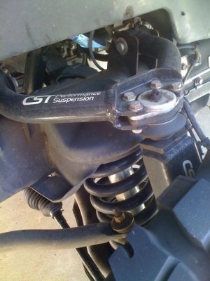

hey bro i had a horrid clunking noise a few weeks after i got my CST lift. after a few trips to the lift shop and some trouble shooting i had to replace my stock UCAs with the CST option UCAs. clunking went away. they where hitting the top can. that was my issue. I love this lift kit. super good 2WD street lift. I have do not take it off road.
here is a pic of the new UCAs installed.
Link for the CST 7" Lift kit and UCA option here.
http://www.cstsuspension.com/products/sfID1/22/sfID2/8/sfID3/66/productID/37
What do you mean by this??? I also read something on another forum that this could be caused by the intermediate shaft in the engine compartment. I plan to reach in there and see if it has any slack in it tonight but I'm skeptical that's the culprit.
