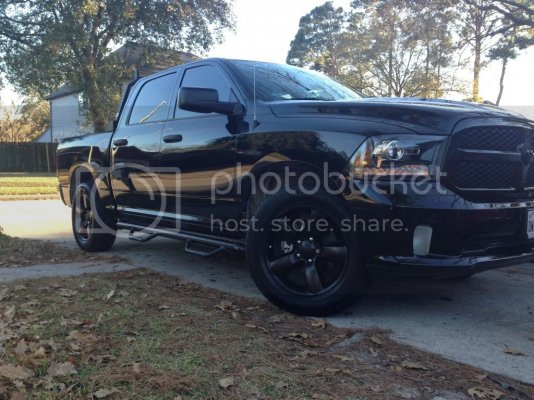

This is what i've done so far to my truck:
bone stock
first side steps and headache rack.
Next was s&b cai and catch can.
favorite pic of my truck

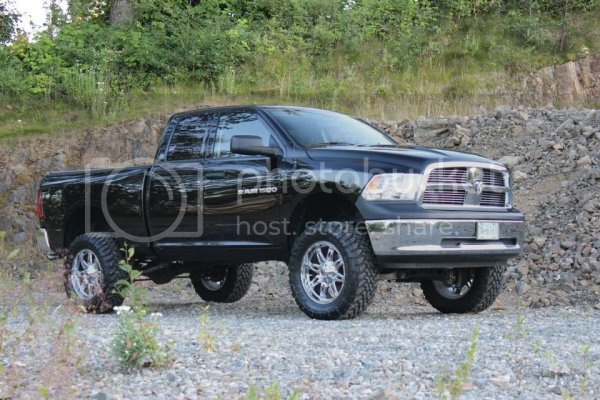

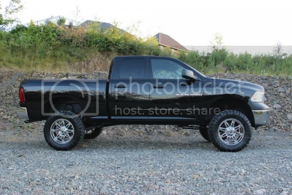

Here's a few shots of my old 1500. As I stated above I was running a 6" RCX lift with Bilsteins at 1.4" and 35x12.5 Toyo MT's on 20x9 -12 offset Fuel Hostages.
For a similar setup with a Zone lift you would want to get the kit with the 5" rear coils and install Bilsteins at 2.1" without using their preload spacer. That should give you almost an identical setup to what my truck had.

Damn that truck is badass. I'll definitely go with the 5 inch coil springs.
