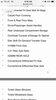

Conventional differantral meaning

K thanks. Does that matter either way preform wise..
I guess when I go to change diff fluid I can use any fluid and without the anti slip oz bottle
No additives needed. The additives are for clutch style limited slips. Even with the anti-spin differential‘s that are in our newer trucks you do not need that additive as they use helical worm gears.. no clutches.
