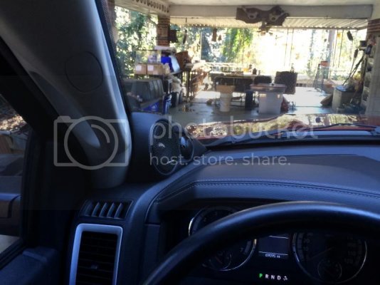

I put these 4.5" in my pillars. Wound up taking them
Out to wrap them in a different material. Probably less intrusive than building a pod around the pillar.
Im doing a set of pillars with 3" in them now for another member and they are way less intrusive. A tweeter could easily be added right above them
In the pillar. I'll post pics when I'm done in a few days.

For the short time I had them playing in the pillar, the stage was much more focused than in the dash location due to the reduction of windshield reflections. The overall response is just so much smoother.
I had some suede that matched the oem color very closely but I dunno where the hell I put it!? I had them painted black for a bit and it just looks real out of place with my dark grey interior. Still up in the air how I will finish them.
They vent down into the dash
