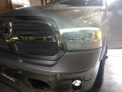

Yet another vote for AlfaOBD, I added the dedicated DRL circuits to my truck although it originally had quads. The Alpharex headlights I added to my truck had separate DRLs, those now function like factory DRLs even dropping out when the turn signal is on.

The extra wiring is for the dedicated DRL circuits to each headlight, that wiring is only on trucks with factory projectors. The dedicated DRLs are different from using the High, Low, Turn or Fogs which a Quad truck without the wiring is limited to.
The top brow light on my truck is the dedicated DRL which the extra wiring is needed for.
