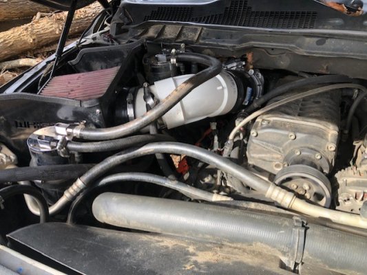

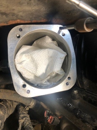

Well this will take next weekend + to complete. I had to do quite a bit of modding. MMX had told me that they have not tried it a Ram yet so they were not sure of the fit. I found out that if they machined the TB side to rotae 45* counter clockwise, it should fit with ease. Then there was the CAI mods. But I made it work and with the pre tune, she's running sooth as silk.
I also found out the Ripp coils seem to be fine. I ran out of time to get cylinders #6 & 8 installed but so far, no misfire on the Ripps.
The bay will get cleaned when work is complete, Lol.

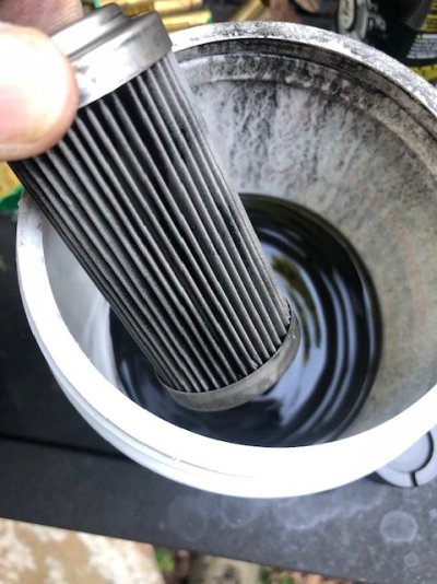

I finally got around to replacing 1 of the 2 fuel pumps that went out on me a while back. While I was in the tank I replaced the fuel level sensor and I could not believe how filthy the pump filters were. The inline Fore filter was just as bad so I replaced it also. This time I completely removed the bed which made the task much easier. Next I have got to get the Nitto's replaced. I need to ease up on the throttle a bit.

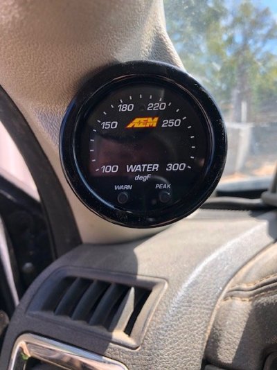

I also added a temp. sensor on the discharge side of my supercharger intercooler. It's been bugging me that the hose and reservor never get hot. I believe there is a vapor lock on the intercooler coil. The guage confirms this. I've tried several things to get the air out that's causing this. I wish there was a bleeder valve on this.

Is you bed actually dangling from the engine crane? That's a Boss move.
Love the USCG approved double clamps setup.
Yes, I usally use 4 straps to the ceiling but saw this on another post so I thought I'd try it. I was nervous about it so I'll use some beefier straps next time. Hey, nothing but the best home brew parts from Lowe's. Lol! I did at lest coat the 4" PVC connectors for the filter to throttle body connection with some black "flex Pro". Thanks.
