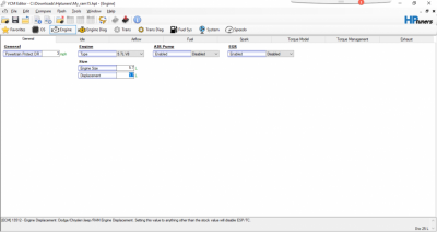

Get Hptuners, then you have two ways of doing it.
Permanently simply changing the displacement value of your engine from 6.4/5.7/3.6 etc to 0 in your calibration with the VCM HPT Editor. Doing it this way will permanently disable your traction control in full until you change the value back to the original displacement in the tune
Or temporalily doing it with VCM HPT scanner, you simply toggle a switch to enable/disable traction control. This is not permanent. If you disabled it this way, once you turn off the vehicle the setting should get re-enable by itself after you start the engine the next time. That means you have to have your HPT device and laptop handy everytime you want to disable the setting.
Haha thats exactly what i did been two years have no tc and lovin every minute .. zeroing out the displacement seems weird but thanks hpt lol..
