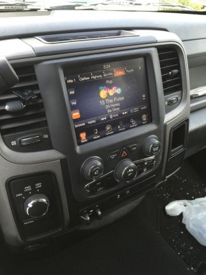

It's alive! Working 100%, minus blower controls till harness arrives, but I just put the factory 5 pin controller behind the bezel and have it set to fan speed 3 which is now on whenever the car is running. ImageUploadedByTapatalk1427849029.775478.jpgImageUploadedByTapatalk1427849037.906748.jpg
