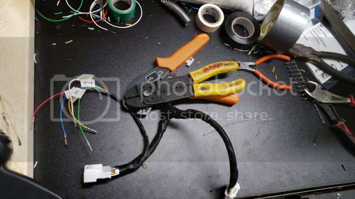

Got as much done as I can on the harness until the 8 pin socket arrives.20150403_220733_zpsni8thte9.jpg
You were smart and did different colors. Mine were all red.
