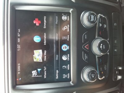

Thanks to the info in this thread and others, I installed my RA4N and upgraded A/C module this week.
Install went pretty smooth considering I am not comfortable with auto electronics.......mechanics ok, electronics NOT! From the VIN# with the radio I know it came from a 3.0 Laramie in Michigan. Works great. The BT voice with phone is much better than the 5.0. Radio seems to sound better as well.
Thanks for all the info!!

Looks nice. It looks like it is available for a firmware update by the color of your icons.....My unit worked much better after I did the update. I highly recommend it.

Thanks for all your help. Will get it updated next week, hopefully.
