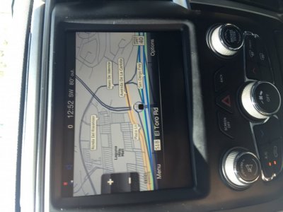

Alright, so after having the 2016 8.4an installed for a little over a week, I have had 2 issues. The first is about 10 percent of the time the menu items at the bottom don't show up. The second item is about 12 hours after installation I started the truck and no radio volume. If I scroll the volume knob or use the volume buttons on the steering wheel, the volume level shows up on the screen but is stuck at 0. This issue remains until I disconnect the positive from the battery and touch the negative to reset the system, then again after about 12 hours, same issue.
I reached out to Sean at Schram and he said that if I took it to the dealership and had the sales code flashed that everything will work. I brought it in to the dealership today and they had no idea how to add sales codes. I called another dealer and they wanted $180. For me it's not worth the money with the potential that it won't fix the issues. If anyone wants to buy this radio from me for $500, let me know and I'll ship it out tomorrow. Otherwise I will be returning it tomorrow to Schram.
That sucks man. After what I dealt with on my 15 RA4 I was afraid to try another one. The 14 I have in my truck has been flawless since install. It doesnt have album art or different themes but it just works!

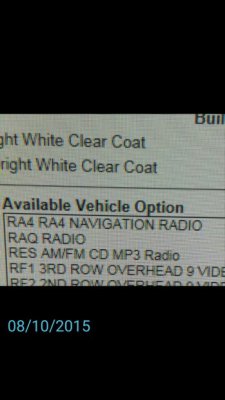

I looked and the RA4 code is present on my build sheet and not grayed out. My buddy who is the Dodge mechanic asked me if I wanted him to add it since I have the RA4 now but I decided to want untill I add the shark fin later to see if I might be able to connect to Uconnect later....also radio works great now kinda chickened out.
