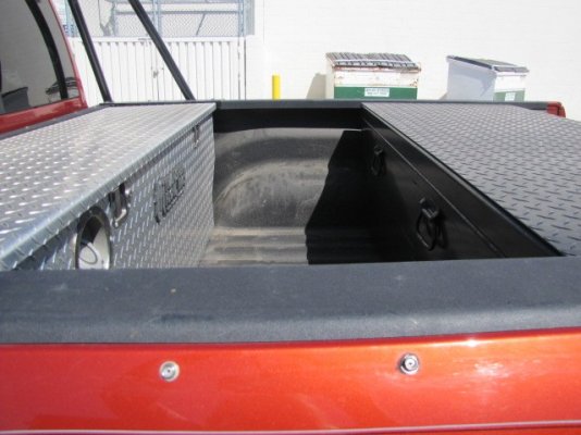

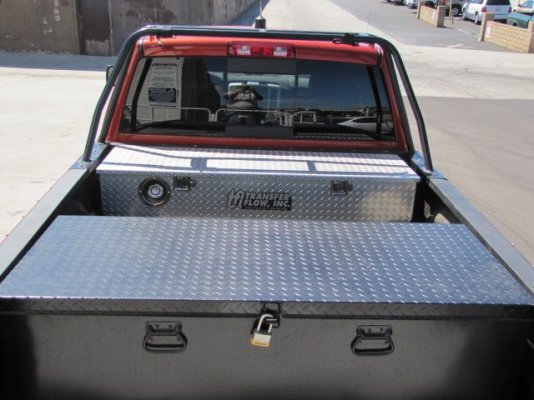

my post was just to give you ideas, not for you to purchase
I bought some Flat Stock metal & 2" X 3" metal tube to mount these toolboxes.
The flat stock went under the bed
The 2X3s were used on the floor of the bed, the tool boxes were mounted on top of the 2 X 3s. ( that raised the tool boxes, so the trucks bed could cleaned )
The flat stock & 2x3s sandwiched the bed floor
you could use aluminum box tube
I used steel, not thinking about rust
