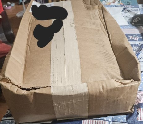

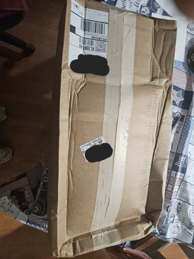

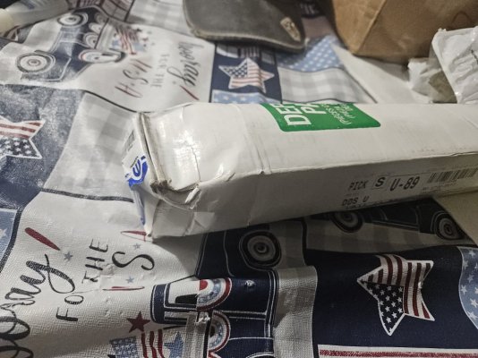

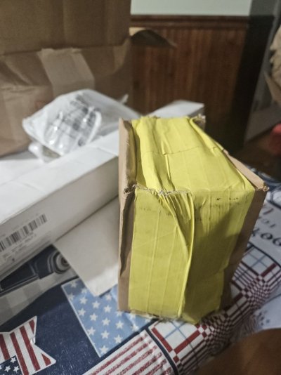

Got my cam, head gaskets, push rods, and crank sprocket today, but damn did they play football with the box:
The head gaskets seem ok, they were on the bottom and kraft paper amongst the other stuff, but that cam is way heavy on top of everything else.
Will take a closer look tomorrow, hopefully the 2 o-rings and crank seal will be here on time tomorrow.
06 Dodge
Jan 4, 2022
2,848
3,413
6.7L CTD
View attachment 569867View attachment 569866View attachment 569865
View attachment 569868View attachment 569869
Was that UPS that delivered it :mad: it look more like one that Amazon delivery people would deliver to your door :oops:

UPS
Actually, at my work, we have more problems with FedEx, but usually freight stuff.
Amazon has generally been good here.

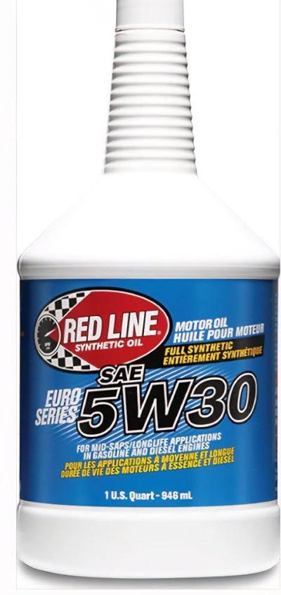

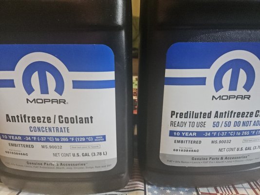

I'm good-to-go, all parts are here, just need coolant, oil, and filters x 2 changes, then my good oil and filter.
Which Red Line 5w-30 is recommended? Looks like they have a euro type??? I may be confused, tho.....lol
Burla
Apr 28, 2012
27,676
58,047
2010 Hemi Reg Cab 4x4
just 5w30 redline high performance oil, not the euro one. For hemi we like moly, especially after work we like more zinc, so non euro formula 5w30. 3 times the moly in non euro.
