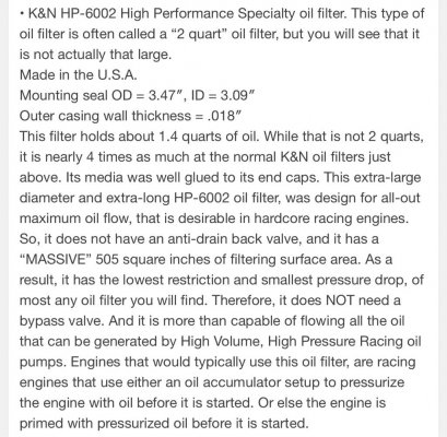

I still have extra 10-48 which I’ll attach as the third picture, but DO NOT BUY 10-47 produced in 2020!!! I’m guessing I’ll be going with the K&N pictured one (fourth picture)when it’s time for new filters since unsure if the Ford ones would work (last picture)?
