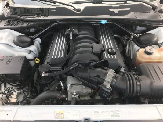

I run the Moroso cans on both my Hemi's. Summit should be cheaper then Moroso themselves.I like the Moroso can as it has dual chambers internally so you can plumb either side as in or out.As Brandon stated they're easy to install no matter what catch can you buy.
https://www.moroso.com/catalog/product/view/id/7942/s/air-oil-separator-kit-large-body85479/
Thanks. But the website says it’s for 09-18 years, not including my ‘19. And looking at the picture, there is no way I have room to mount in that location. Not that it wouldn’t work with different mount location.
Engines are the exact same from 2011-2020. They Havnt changed the engines at all (hence lifter failure and manifold bolt problems just sayin) just the engine plastics have changed.

I didn't realize you had a 6.4,a catch can on a 6.4 would take a bunch of work,as you don't have an external PVC system like the 5.7's do.The Moroso cans mount to either the radiator support or the fender,they don't mount to the engine.In your case unless you wanted to spend a bunch of money on aftermarket or hellcat valve covers,or fabbing breather ports into you're existing valve covers,you're pretty well sol.

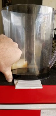

I dumped mine out the other day. It was 80% full of nasty smelling goop. I'm glad mt engine didn't have to digest that crap.
