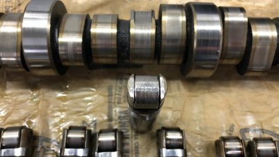

When I see photos of failed Hemi lifters it looks like it's always the roller stops rolling and just grinds on the cam like this
I'm not a mechanical engineer but if you think about it, the inside of the roller has an axle that's in almost full contact with the inner bore of the roller surface while the outside of the roller is only in contact with the cam at one specific spot. Oil is lubricating both sides of it but you have to admit that's a bit of a balancing act for which surface is going to slip first, right? If the contact area between the axle and the roller is 0.05 square inches and the contact area between the cam and the outside of the roller is 0.025 square inches, wouldn't it just want to slip on the cam instead? And over time if it gets a flat spot it's going to just stay there on the flat spot then before much longer you got game over for that one.
Doesn't seem like anything to do with MDS, remember the non-MDS ones fail too.

chrisbh17
Oct 12, 2017
6,720
7,525
Afaik the rollers do have needle bearings. My uneducated guess is that the needle bearings eventually fail, possibly due to oil starvation, or maybe just because of cheap needle bearings.
Once that happens there is no more rolling and it starts to eat away the cam. Some people have even reported the lifters spinning in the lifter bore and then the cam is rolling against the side of the litter instead of the actual roller. That REALLY wipes out can lobes.

MDS does not have anything to do with the mechanical failure of the roller lifter. The failures occur on both MDS and non-MDS lifters. The bearings on the roller tips seize and flatten the cam lobes.
I have had lifter failure occur on 5.7's and 6.4's even after MDS has been deleted.
