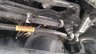

OK, I went ahead and had them do it. Here's why: the only potential problem seems to me like a slightly offset steering wheel in the future. The toe of the front wheels can still be adjusted on the tie rod between the two wheels. Please correct me if I'm wrong. Here is a picture of what they did. It looks like a weld about the length of one side of the sleeve, and then some sort of rubber cement over the weld. It still seems like a chicken-**** way to fix a $40K truck, but I'm hoping I won't have to ever think about this again!
You are correct, the toe is adjusted through the tie-rod, not the drag link that they welded. So some day when you have an alignment done and they change the toe, your steering wheel will not be straight unless you have the welds ground off and the drag link adjusted.
Yea, I can live with that. It might annoy me a bit, but I'd rather not have to check these constantly for the life of the truck. Thanks for the confirmation!
