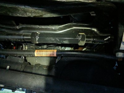

They should be replacing all the drag links period. They do the weld fix because it's cheap and most people don't know any better so they get away with it. That ain't right IMO.

Actually I think they are doing the weld fix because they do not yet have a redesigned drag link to replace it with. Everything I have read says that a replacement drag link is not yet available. It’s still a joke and nothing a little loctite can’t fix or even better add a second set of nuts to jam against the two that are there and it will never move.

If they insist on welding something, why are they not welding tangs on each end of the drag link that will push on the nut and prevent the nuts from moving?
At least that is undo-able when (if?) they figure out a real fix.

THAT there makes more sense then doing ne thing else, Easy to back off locking nut, adjust, redo locking nut, such an old time but smart as heck Fix

They will never weld mine, but my question to those that do get it welded. Have you asked the dealer who covers the additional cost when you get an alignment done? An alignment shop isn't going to cut that weld out and if they do they will charge extra for it. And after that who welds it back? Again, the alignment shop isn't going to do it, not without charging more (if they even have the ability to do it)

Im on the side of you guys....crap fixes just make the trucks seem like crap. Welding the nuts is a perfect way for them to keep it together until its outside of warranty. I am sure they wold be more than happy to take even more of your hard earned money if you try to get them to align it and they see the nuts are welded.
I could understand if it is an urgent emergency, but this does not seem to be. And even if it were, there are many better alternatives like red loctite, some form of safety wire or tab to prevent extra movement from the nuts, etc. Red loctite is probably even easier than welding, their 16 year old oil change jockies could be assigned to it.

I spoke to my Dealer today. He said they had all the trucks on the lot welded as they can't be sold with the recall not done. However he drives a 2017 Ram and said that he will not have his done as long as welding is the fix. His recommendation is to make sure that the bolts are as tight as I can get them. So I'm gonna get a 41 MM wrench and go to work.

It is truly ashame (and FCA should be embarrassed) that the "fix" for this issue is welding nuts on a drag link that has an adjustment there for a reason, so steer ahead can be set during alignment.
For those considering allowing the weld understand that once welded the only way to set steer ahead is by disconnecting the tie rod ends from the steering knuckles one at a time till it's as close as they can get it while keeping the toe setting within spec.
I dont consider that a "fix" at all. It's something that I'd expect to be done in someone's back yard who doesn't care about doing the job right, just wants it done as cheaply as possible. This is about as unprofessional as it gets in my opinion but I've been spinning wrenches for over 30 years now and was taught to do things the right way or not at all.
I'll loosen mine up, apply blue lock tight, re tighten them, mark them and then monitor them. Address it if it happens again. The suggestion of adding a set of jamb nuts was a good one. Lock those down and it would not go anywhere.

Just signed up for the forum to post here. I got the recall notification last week and had the "fix" done yesterday on my 2017 with 11k miles on it. I take my ram to the dealer for all service and they are pretty decent so I let them do it. Everything was tight so only the welds were done, draglink was not replaced. I dont expect to pay more for an alignment if it's needed in the future.

So if the issue is that the nuts are loose enough that they can back themselves off (even when torqued to spec), once both nuts are tack welded to the drag link, will the WHOLE THING now be able to move also?
