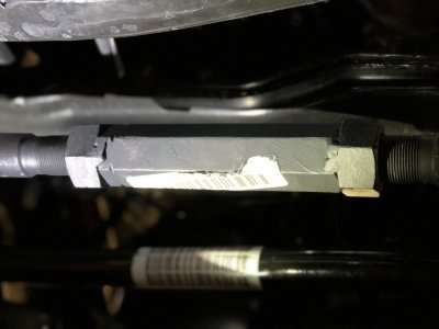

Drag link ok? I guess. Dumb question, what does a welded drag link look like?

I checked mine today it looks good.. I'm going until they come up with a better fix

Took mine in today and refused to let them weld the nuts. the dealer was fine with this and even said they didn't blame me. I told them to lock tight the nuts and they said that was probably a better fix but they could not do it, told them I would do it and was told the torque value was 15 ft/lbs. they also dont think the weld repair is the final fix.
15 ft/lbs. !!!?!?!?!?!? WTF!!! No wonder why they come loose on them!
Put a set of wrenches on the damn nuts and put your ass into it and be done with this stupid ass recall! This is sooooo STUPID!

It is more, it’s 109 ft/lbs. 15 ft/lbs is the initial spec for checking the drag link adjuster jam nuts before they are welded or the adjuster threads inspected. If the nuts pass 15 ft/lbs and there is no movement, then they are torqued to 109 ft/lbs and welded.

Yes that does make more sense than 15. I'm still gonna lock tight mine at least I can still get it apart if adjustments are needed

Just check it yourself and make sure it’s tight. It’s not magically going to come off. Tons of people never get under their trucks. The fix sucks the problem is eh.
