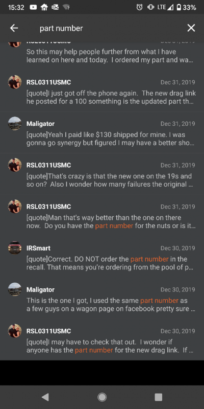

So I got some parts in the mail yesterday...…………...they just sent me the lock nuts! lol. She said that's all I requested. I kindly highlighted the drag link part # that I requested as well. haha. We'll see what happens now. Guess two nuts for free are better than nothing!
Sooooooooo they are giving you the same old ************* drag link (or nuts anyway)?! Wth
