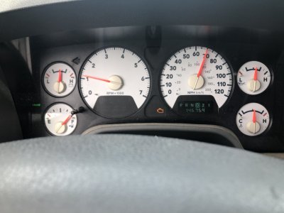

I have a 2006 1500 4wd with the 5.7 Hemi. Three years ago, I had the computer malfunction and fire one of the cylinders at the wrong time, smashing the spark plug and costing about $2300 in damage. The check engine light intermittenly comes on with left side lean. There is a hole in the exhaust due to rust, but I had noticed that the truck seems to lack the power it used to, and I run seafoam religiously through the gas and brake booster. A couple of days ago, the truck was running fine, when all of the sudden it shuttered and the red light came on. The truck barely moved, so I pulled it over. Turned off the ignition, and it started right up. I went another mile, and it did the same thing with a loud pop (like a balloon popping). The CEL came on, but I made it home and pulled the battery cable off for about 20 minutes and reconnected it. It kicked out the battery disconnected code, and hydraulic pressure low. I tried relearning the throttle body, which I read here, and in the process, the CEL went out again. I thought it was fixed, but about 20 minutes into a 30 minute drive on the interstate, the truck shuttered, lost power, and the lightning bolt came on again. This was while going 70mph. I put the transmission into neutral and started it, and it kept driving. I was in the middle lane in rush hour traffic. Scary. Most of the time there is no CEL that came on, but yesterday the CEL came on. I will recheck that, but should I just assume I will buy a new throttle body? https://www.rockauto.com/en/catalog...,1432338,fuel+&+air,throttle+body+gasket,6474 has them for 1/2 the price of autozone, so if that's the typical fix, I will go with this. Or should I take off the air intake and douche the throttle body with carb and choke cleaner?

First try to push the connector all the way in on the throttle body. It may not be making a good connection. I had to give it a good push on my 07 to get rid of the lightning bolt. I also cleaned the plug and male connectors. Try this first it only costs some time.
