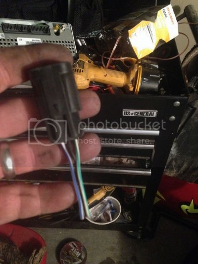

Problem solved. It was a bad pigtail on my aftermarket lights.
I cut the OEM one off my original light soldered, heat shrink and taped
Aftermarket one had a bad pin in it
