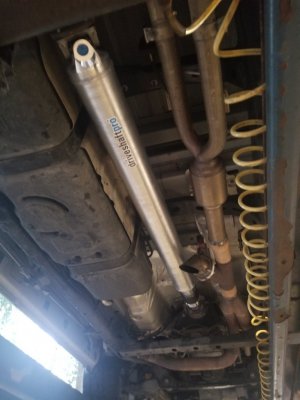

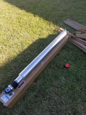

Any idea on the install orientation of the driveshaft, or does it matter ?

Ok, smaller diameter to front of truck and larger diameter to differential. Thanks!

Nice, did you do a crossmember notch, and if so, where did you get it? :)

No crossmember notch, I need to load the bed of the truck with weights and see what my clearance is.

I presume the air line is for ad on air ride?
