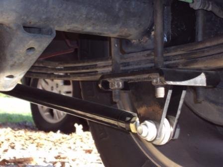

I did this many years ago using a Mcguaghy Flip kit. They are marketed as a bolt on kit. But if you are making hp I recommend welding the spring perches once alignment is confirmed. Mine is now down 6 inches, but I think the photo shows 4 inch drop. What's nice about doing it this way is you can make it any level you want such as a true 2inch if wanted.
