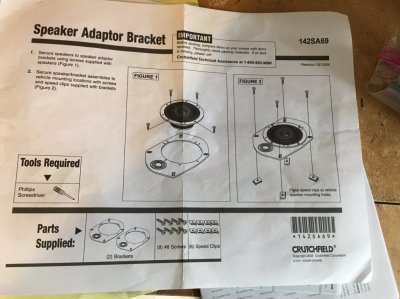

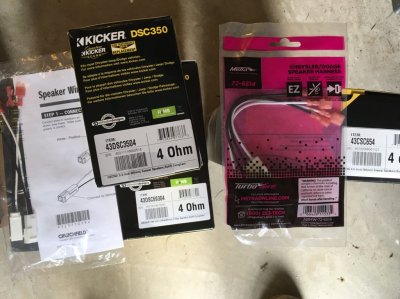

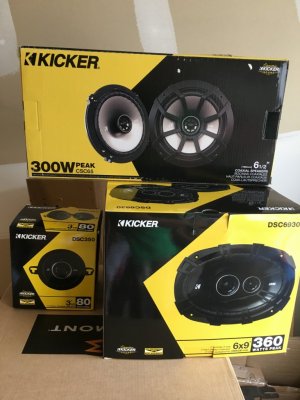

Not to thread jack, but I wanted to thank you all for getting me off my ass to finally get my radio in better order. I just did the Kicker replacement upgrade on my 14 Express with the 5.0 radio and it’s far and away so much more awesome than OEM.
Here’s the components you’ll need for the simple but oh so gratifying upgrade.
And if anyone needs the Metra/Crutchfield adapters for the door speakers or dash tweeters, I have a pair (2x) of each (as seen in the last photo). Just PM me if you need em, pay for shipping and they’re yours.
I almost forgot about the adapter for the front door speakers. There’s a pic attached as well.

Interesting, those 3.5's might be good in the dash. Thx for the head's up.
GIJoe2010
No sh*t, there I was . . .
Mar 23, 2014
1,931
1,524
Killeen, TX
Those fit perfectly under the plastic covers on the dash, no cutting or finagling. I will say though that some ****** at the factory buggered up the alignment of one of the bolt holes so one of my screws on the driver's side went in at 30* and not straight up.
