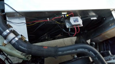

5.2 Magnum
My setup
Sent from my SAMSUNG-SM-G925A using Tapatalk

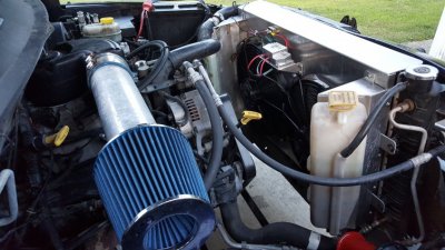

Looks good but cant tell much from the picture
Type of fans
Controllers
home made shroud?
Kinda curious how you wired it all up
Think those are the only other two I had.
