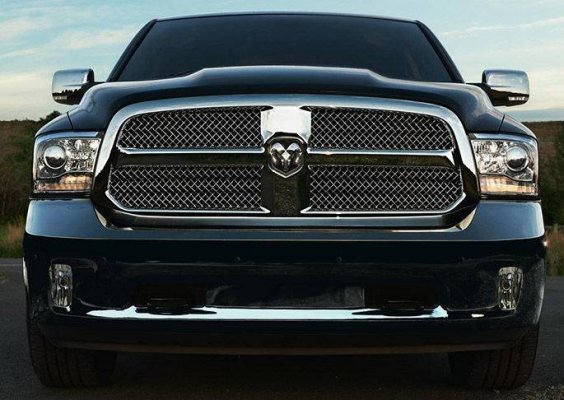

I am also thinking maybe the big horn grille doesn’t flow as good as others.
Your correct about the BigHorn grill not flowing air well. There are only small oval openings in between the cross slats.
The three best factory grills for air flow is the basket weave (Longhorn), egg create (Outdoorsman) and the RAM Pig Snout grill. See attached pics
