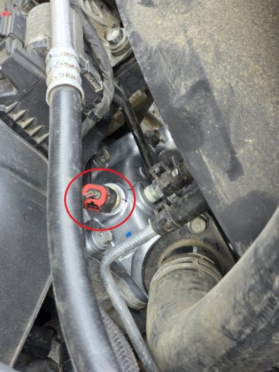

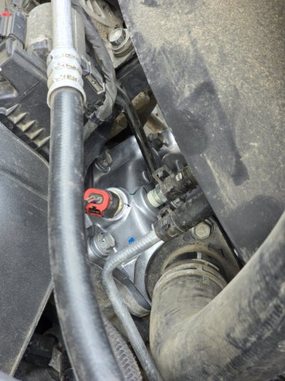

I got a motorad premium t-stat. Was not keen on spending $100+ for a t-stat from the dealer. And in the first picture I don't have that drain plug. The hose runs to the oil filter. Guess I could have just popped the hose? I also did squeeze the top hose when it stopped bubbling. The other picture is what I used to "bleed" the system.

Make sure the giggle pin(if you have one)is clocked correctly on the t-stat...I think its straight up..others can chime in for sure on that...I didn't notice it on mine until temps went north of 220..i took it back apart and it was off ,reassembled..normal 203 area again...prolly trapped air in my case.

Correct, if it has the little hole and pin on the t-stat - install the t-stat so that piece is in the 12-o'clock position.

The t-stat has the pin and I made sure it was at the noon position. Any recommendations on a good, not $100, thermostat? I used to use motorad t-stats in the past and didn't have issues. Guess, like everything else anymore, it is cheap chinesium sold as premium. Drove on the highway today and it was still around the 215-222 range at 70. Temp outside was 72 but humid so running the ac. Haven't added coolant since the other day. Just checked the rad and it looks like it needs more. The reserve/overflow stills shows "max"on the dipstick. So I guess there is still air trapped in the system.

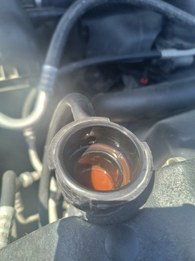

I put on a new water pump wnd flushed my cooling system in March. Here's the current radiator level on a cold engine.
Weird how the new Mopar purple coolant looks rust red in some light. It turns purple in the shade.

Mine looks like the same level but that upper hose is squeezable. Like an empty hose. I've put two gallons of coolant in already. Isn't the system like 3 gallons? I don't remember that much coming out. I smell coolant every time I park but I just attributed that to the coolant draining everywhere. Gonna be pissed if I have to shell out another $300 to have the system flushed just to get it topped off.
Yea, about 3 gallons. But the coolant in the heater core and in the block wouldn't have drained out when you replaced the water pump. So, wouldn't have been replaced.
