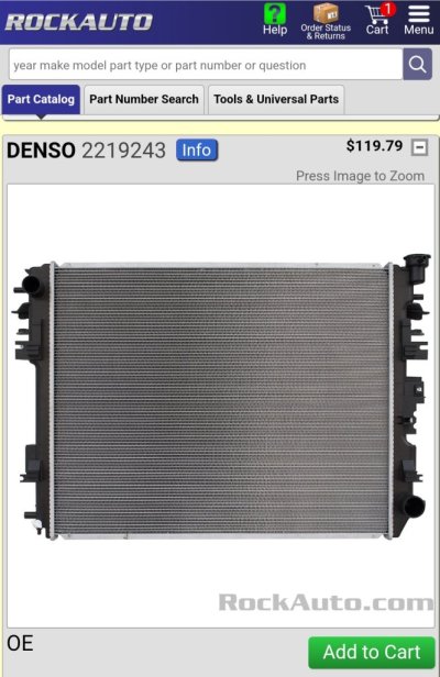

Here's the one I got:
Rad was $119, but was $100 to ship. Still cheaper than local, though.
