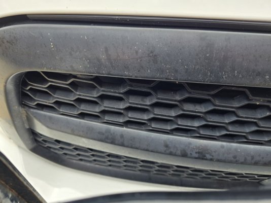

Pull the middle shutters out of the AGS for the summer,then pop them back in for the colder months.
By chance what grill do you have.
The Sport/Bighorn grills restrict airflow,the Honeycomb grill is far better at letting airflow through.
This is the grill you "don't" want
Safe to assume this is the honeycomb? And this is the grill guard I have on as well.
Is it possible the actuator is defective for the AGS?
Jan 17, 2016
23,665
54,348
14 Sport
Have somebody start the truck while you look at the shutters,if they cycle/move odds are it's working properly.
Remove the middle shutters,just leave 1 top and 1 bottom shutter in on both sides.They just flex to pop out.
Pull the plastic cover at the top/front of the rad support,and you should be able to reach in and pop them out
