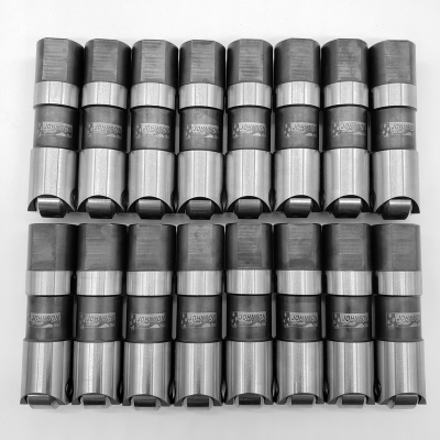

Johnson Lifters (best of the best): https://johnsonlifters.com/Products/HydraulicRollerLifters/2326.aspx

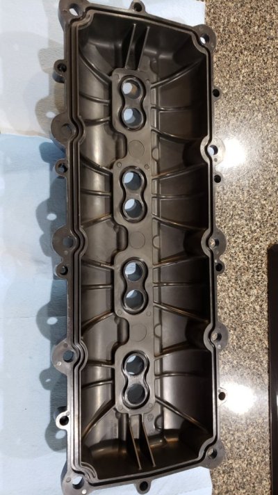

I just replaced a valve cover seal, take a look at it, at 40K miles it looks like new.
After this, I did another cleaning with Liqui Moly Pro-Line Engine Flush. My HEMI is spotless inside, and I intend keeping it that way.
