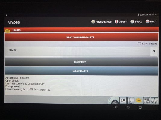

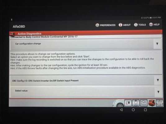

I also found an option to change the ERS config, but was wary of changing the setting:
