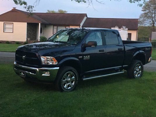

Truck is gone. New (to me) 2018 2500 6.4 Hemi in my driveway now
