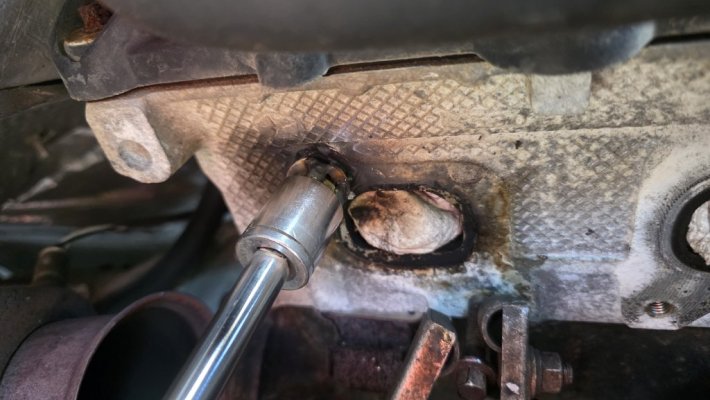

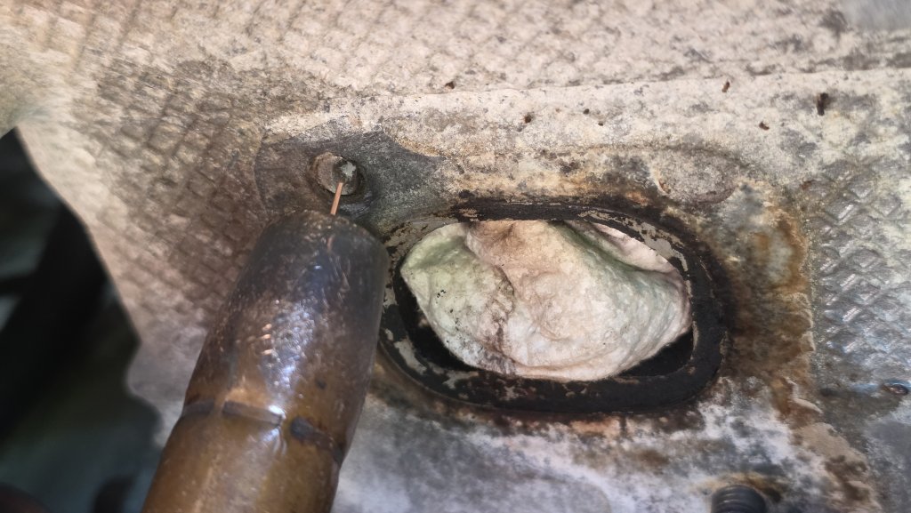

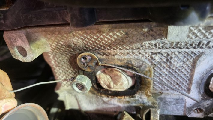

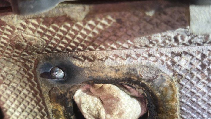

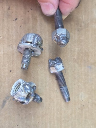

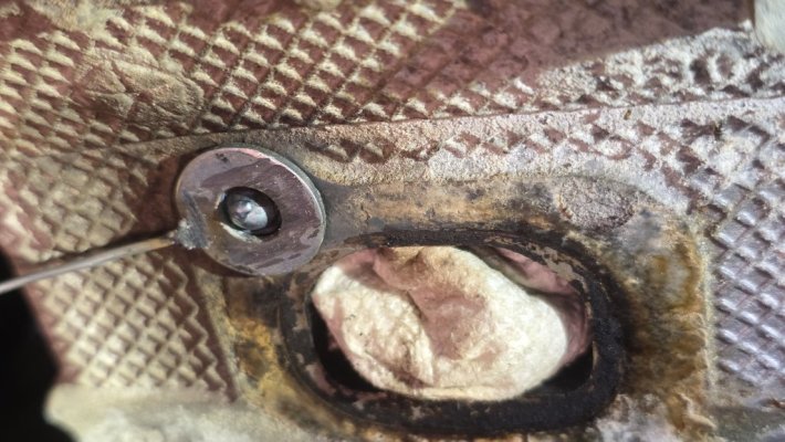

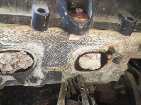

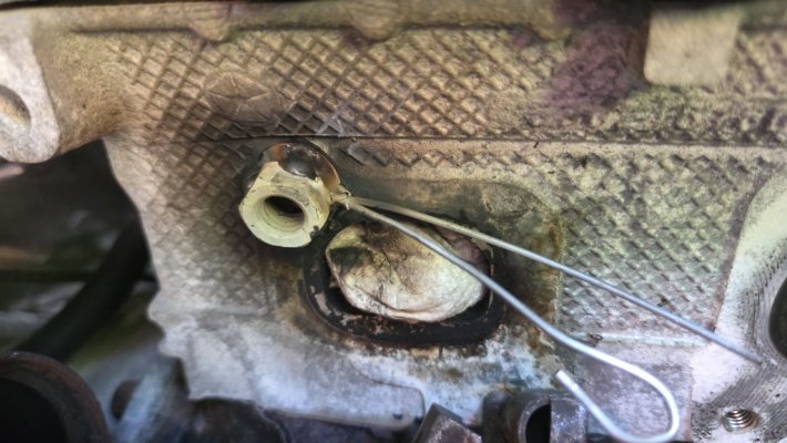

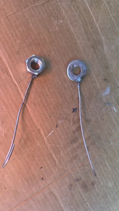

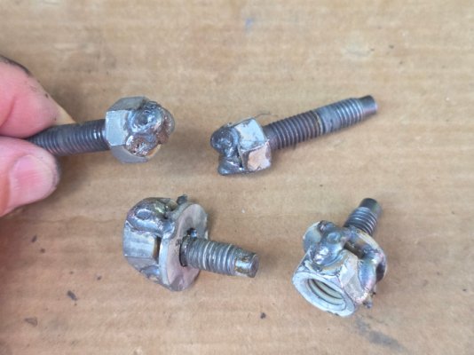

Guys/Gals,
I put together a PDF today (see attachment below) with pictures how I removed all the broken exh bolts on my tk using the 'Welder Method'. My tk's bolts were broken in the usual locations, which are tricky to get at with a drill. This method has been discussed in detail on the forums many times and there are Y/T videos. Not 100% foolproof but usually a high success rate. All mine were extracted w/o damage to the head. I've used it on other vehicles in the past. A possible option for guys with a welder & steady hand.
Note: I also dropped this in the 'General' forum section ...forgot there was an Exh manifold section.
Note 2: This is NOT a recommendation or suggestion what others should attempt ...but an account of what *I* did. Always have a professional service your vehicle.

Here are pictures of what's in the PDF Tech Article (previous post #404) ...below. Pretty self-explanatory. More explanation is in the PDF. Like I say, I'm just throwing this out there of what I did ...not a recommendation of any course of action anyone else should do (covering my butt here), ...or discounting the drill method (which I've also used on vehicles in the past).
