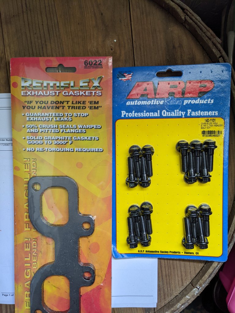

I mentioned this in another thread... the bolts on the flanges connecting the manifold and y-pipe on the passenger side are massive bent (yeah those thick ass flanges out toward the mounting holes are bent), even the flanges are bent, like someone massively over torqued them, is this common from the factory?
On closer inspection the top rear most manifold bolt does not look like the others... there is no rust or oxidation on it... all the others have some kind of oxidation... me thinks this one has been replaced,
Only had the truck for about a month so I know nothing of its history.

Also, the exhaust bolts you speak of are normally super tight from the factory.
