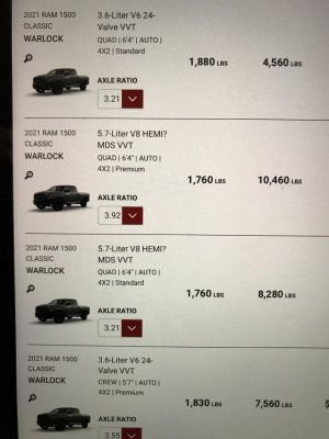

IMG_2714.jpg He's maxed out with those 3.21s. 3.92s, he had a little wiggle room. My Standard Reply: Lower Rear End Gears!
