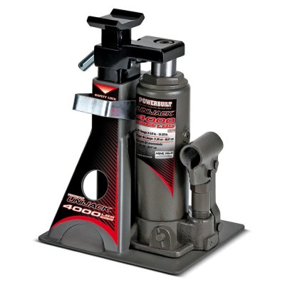

Sounds good, glad you found what works. You may want to use rhino ramps, makes it much easier. Also, next time put a bag around the oil filter when it starts dripping. Also, these are good not only for changing oil but doing brake work or anything that is easier when you jack up the truck. It is a jack and a stand allinone. Read my filter page in my sig, but m1 is a very good filter, it's a blend much better then just paper.
