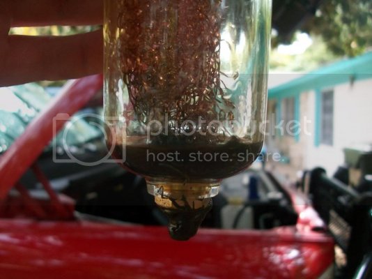

I know my truck is a decade older than y'alls trucks, but I've been seeing a lot of catch can stuff here in the 4th gen section. The above picture is of my homemade-rigged Kobalt catch can. That oil build up is 110 mi of mostly highway driving.
That crap is what goes into your intake manifold. I know for a fact my PCV hose on the other side of the can is cleaner than it used to be.

I haven't pulled my air cleaner lately, but last time I did, my intake was much cleaner than before I put it in.

If you're thinking about it:
DO IT
The only evidence you need is the picture I posted and Johnny's testimonial.
I haven't seen an MPG increase out of mine, but I just like the peace of mind knowing that my engine isn't sucking oil down its throat.
