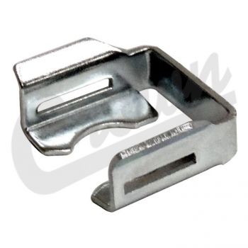

I had taken my truck into the dealership to have them find an issue that I couldn't figure out. While they were working on it, they had noticed the wire clip was missing on all the injectors. Would someone happen to have a photo/part number or knowledge of where to get replacements? Or do I have to replace the whole injector harness?

This is what the fuel injector retaining clips look like. You can hit the local salvage yard or Amazon to grab a set.
For the trans, there are several types of overhaul kits available. It's time to do some research so you can make an informed decision about what you actually want. If you have plans in the future to start modifying the engine then I would build the trans now with some good, quality performance parts and be done with it. You really only want to do it once. That way no matter what kind of power you make the trans will be able to handle it.

Would you happen to have the link to the part in Amazon? For the rebuild kit would anyone have a suggestion as to what kit and stall converter?

Here is the link to the injectors clips on Amazon...
https://www.amazon.com/Fuel-Injecto...819525119&psc=1&ref=&adgrpid=71965060518&th=1
