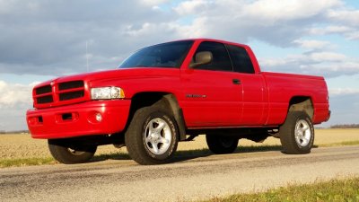

2001 Dodge Ram 1500 4x4 5.2L

The transfer hose on your fuel pump it self may have sprung a leak before it makes it to the top of the pump module in the tank. It a little corrugated hose about 3.5 inches long. Your truck looks very clean you might just unbolt the bed and raise it up to get to the top of your tank so you don't have to fight a full tank of gas. Also check your injector signal with a noid light
