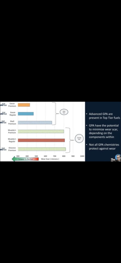

I know Lake does not like fuel additives, but I have some Redline SL-1 and will get more. I also have some Amsoil P1 for another vehicle, and will use it as well.
Before gas prices went insane, I was using Silver (89) all the time and Gold (91 and 94 when near specific stations) in another car. I stopped the Silver for a bit. But after this video I may grin and bare it and use Silver again. I suppose it works out to another $40/ month more give or take in the big picture for me and my driving personally.
Burla
Apr 28, 2012
27,468
57,571
2010 Hemi Reg Cab 4x4
Lake often doesn't include the best products because they tend to disprove his premise. Not including si-1 the best fuel additive, omitting biotech in oil additive vid for the same reason, and he did admit bgmoa has a purpose but underplayed it's benefit. Not only does si-1 clean better then anything known, but also adds lubricity which was another point to this vid. He is a great resource, but lets face it he is also a corporate insider, so take the good info he posts but also consider what we have for evidence.
