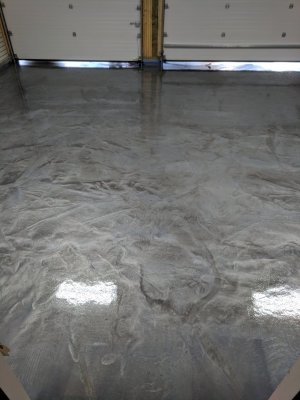

You got that right. Did save about $4.5$ doing it myself though. It turned out nice, just wasn't the look I was going for. Really wanted the white with gray for a nice contrast. It was also super messy and time consuming. I was on the fence between tiles and epoxy but went epoxy because of the look I was going for, which I didn't completely get.
I also taped by the garage doors for a pine to draw the epoxy to, I think that line was a bit too far out extended past the garage floor, plus it's going to be "fun" trying to remove painters tape with epoxy over it. I was planning on probably putting a threshold down since one of the doors doesn't completely seal at the bottom. I also plan on painting the exterior apron infront of the doors since I need to do some patch work. In the end, I think it'll be good, still a lot of work to do like painting the stemwall as well. Would have loved to epoxy those, but it was already a bit of a stretch for this doing it all completely by myself and adding the stemwall would have been too much with the short working time of the epoxy.

Here's a pic of the latest right after the poly layer. Man this stuff reeked bad. Worse than regular poly. If I didn't have the full face respirator, it would have put me out for sure. The house reeked and had to be aired out for a couple yourself afterwards just from having the empty mix bucket in the hall for 30 minutes while I spread everything.
If you look closely at the pics you'll see bunps, that the antiskid I added. I threw a bunch down since it was super slick with socks on, can't imagine how dangerous it would be when wet.IMG_20181021_103435.jpg

IMG_20181021_172529.jpg Pulled the tape up, wasn't too bad at all with a mudding knife. This coat is THICK. I'm guessing somewhere near 50 mil. Looks like the line for the doors is about spot on. Guess I don't give myself enough credit lol.

Very true and the antiskid definitely helps hide the bubbles and imperfections. The swirling inconsistent look helps as well. Just need to cross my fingers that all cures well. There were a couple of spots in-between coats that were tacky and didn't seem like they were adhering well, but with as many coats as I put on, I'm hoping to be alright.
