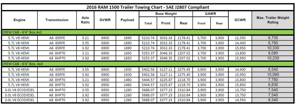

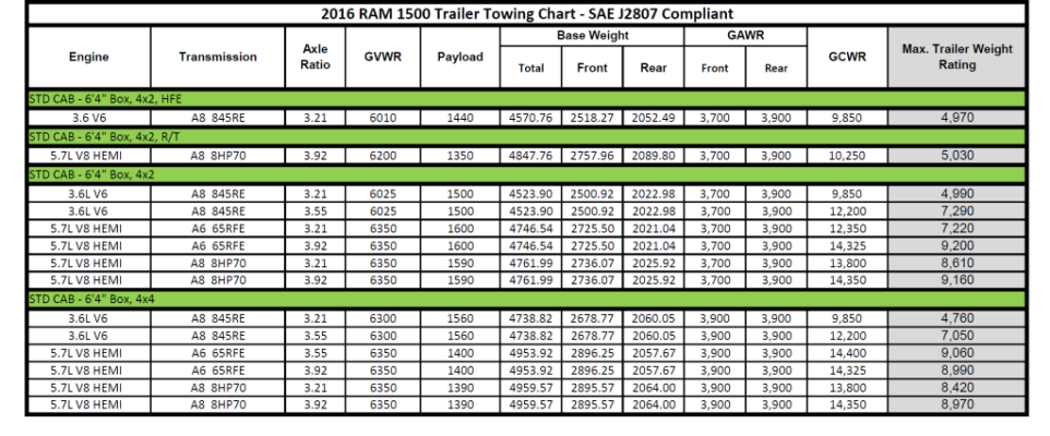

At least take a look through the haul numbers. The OP IS NOT proposing to do anythjng that is not within his trucks publised capabilites let alone your characterization of what he is proposing to do.

As I said, a lot of assumptions here and almost no data. The chart is of dubious value since we don't know what OP has added to the truck beyond tire and lift and we don't know what options were on the truck which might subtract from the chart max.
I see the haul number but without a CAT receipt of OP's fully loaded trailer and fully loaded truck ready to tow and the VIN towing data and door jamb data, my best analysis is that the stated trailer weight of 10k is within a few tens of the best-case scenario chart value and that is not allowing any wiggle room for all the unknowns. And a generalization that is more often true than not, 1500s will run out of payload capacity long before they run out of trailer towing maximum weight.
So, yes, if we just use the chart, OP is proposing to utilize the truck beyond the chart's capacities (capabilities as you stated) because in the chart the maximum PC for any 5.7 3.92 is approximately 1,700 pounds. 15% average tongue weight of 1,500 pounds leaves 200 pounds for OP, any family members including 4 legged ones, hitch, gear in truck and bed, and any options already added like steps, bed cover, etc.
