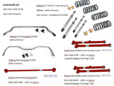

I have done up to 120 mph and even taken a pretty tight and bumpy bend at 120 mph, the truck handled it surprisingly well (for those who haven't tried it, one of the most hair-racing things in a truck is to take a high speed bend and then hit some bumps). :crazy:
Lower it with the best components, leave a little rake and hold on with both hands! ;)

Strut/tower brace is useless on the trucks since the upper spring pockets are welded directly to the frame and they are BEEFY mounts. You can upgrade shocks, the adjustable QA1s are the best option (Dave has them listed in his equipment picture I believe), but the air ride is what is really holding you back. A dynamic suspension will never handle as well at speed as a 'solid' suspension will because there's inherently less resistance in the suspension travel which is why they are more comfortable.
This is one of those cases where it's one or the other, I've sacrificed some comfort for the absolute 'feel' of the road but I have great results and love the way it drives... my wife doesn't agree so much.
