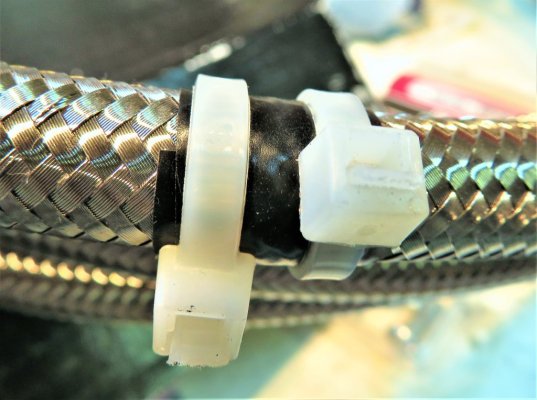

If you end up having to make your own lines,i wrap the braid with black tape as tight as possible,then use 2 small zipties on each side of where i'm going to cut,then i use a thin zip disc / cut-off disc in an angle grinder to make the cut. A set of proper A/N vise jaws makes a world of differance for installing the fittings.
Yeah it’s 10 ft line I already put the ends on. So much easier than stainless an lines

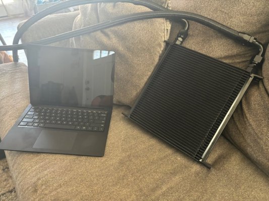

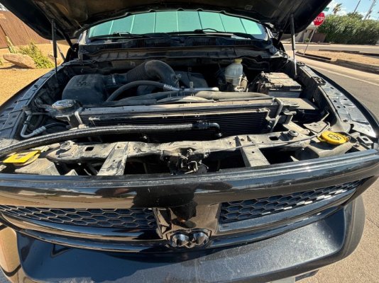

Small oil cooler arrived today… 13” laptop size comparison

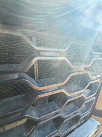

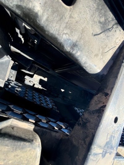

Kind of hard to see how I’m planning on mounting… will take better pics on actual install with the grill off
Decided against locating it behind the bumper as I have sunk that in mud before.
Lines will route down under the radiator along the frame rail to the filter location.
Most likely going to get a 4 row radiator also… I know this is over kill and unnecessary but #Phoenix
