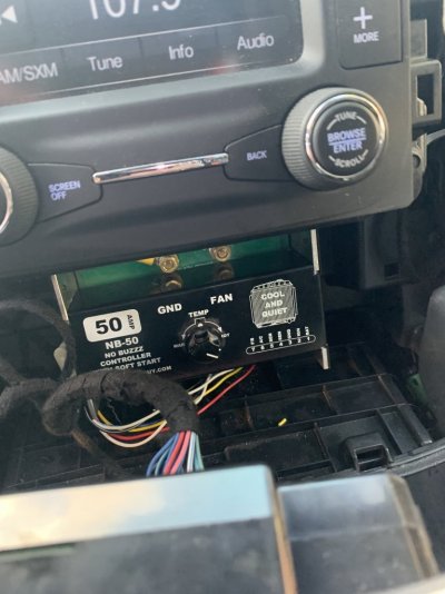

I can say this isn't correct from trial and error. Without the mechanical fan my coolant temps ran about 10 degrees hotter than stock with just the untuned efan.
With both the efan and mechanical, my coolant runs about 5-7 degrees cooler when towing.
Interesting. My coolant with my Efan and 190 tstat remains around 194° under most circumstances. But i run a standalone variable speed controller so the temps don’t fluctuate so much. I have my controller set higher currently then prior because it’s so hot out that even on stock control the fan basically wouldn’t shut off very much with highway driving. I’m surprised running the stock fan unshrouded actually does much of anything since it’s not directly pulling air through the radiator. Maybe because it’s forcing more air across the engine block. I debated on reinstalling the stock mechanical Fan and shroud but didn’t want to purchase a whole new assembly. I saved mine for a year then got rid of it. Hard resentment there. Sometimes I wish I hadn’t swapped to the v6 fan. Also though. Untuned with e fan doesn’t do squat since the truck wants to run at 220°. And tuning for the efan is always 5-15° above tstat temp to prevent the fan from constantly running. The newer trucks use electric only with pwm control to regulate fan speed based on engine load. My controller I run uses radiator outlet temp to control fan speed which is a similar function to engine load. I could set my temps slightly lower and my truck would stay 192° constantly no matter what.

My controller I’m running I ran pre tune with a 190 tstat with no issues. No tune requires. But no benefits to it honestly unless you are tuning for performance. I actually ran it with a 180° tstat but didn’t like it that cold since I’m not going full blown performance.

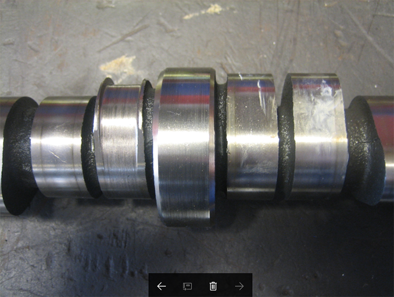

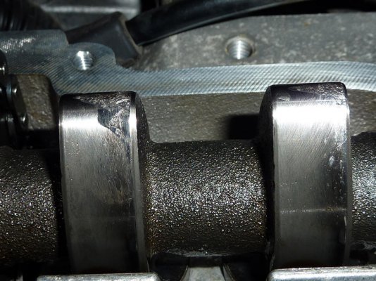

Think about this, what exactly ON a cam or lifters could possibly cause a tick? Literally the only moving part ON either item is the roller and needle bearings, other then those it is solid metal. The part moves yes, but not on itself, only the rollers. We know as a fact when the roller and needle bearing fail because it is a specific type of damage, and this happens to be in very few cam wipes, most are smoothed over time like below. You can see when needle bearings fail because the posts of the lifter pit the cam lob, so changing lifters and cam in that case would likely work. But, even in those cases we don't know if something causes the rollers to collapse or if they just fail. Either is possible, it is possible there is restriction in the lifter bore causing extra pressure on the rollers, and some rollers just fail, but again that is a small percent as you can easily search hemi cam lob damage for yourself, very few are pitted as opposed to smoothed. So if the lifters are solid and the cam is solid and it turns out the needle bearings are fine, why do people think that changing parts will fix hemi tick? What exactly about new parts stop tick over the old parts again if it isnt the needle bearing.
By the way, they tried fixing needle bearings in 2016 with beefy bearings, yup we still have hemi tick after. When the roller fails the damage tends to be on the wide where the post hits the lob, not in the middle.
Oh, dat's beautiful!
What's wrong with spalled cam(s)?
Prevents valve float.
I agree with pretty much everything here. I realize I'm beating the dead horse so don't feel the need to respond.
My thoughts are:
- Isn't cam pitting typically a form of chemical reaction? Corrosion, or acidity. Or undersprung valve spring? I've seen where the roller is so worn that it's basically level with the outside of the lifter like the left one below
- I feel ticking is a lash / clearances issue - again assuming that the ticking is coming somewhere from the cam, lifter, pushrod, rocker arm section of the valvetrain. (I could be totally wrong, but what else is rotating to cause an rpm dependent tapping?)

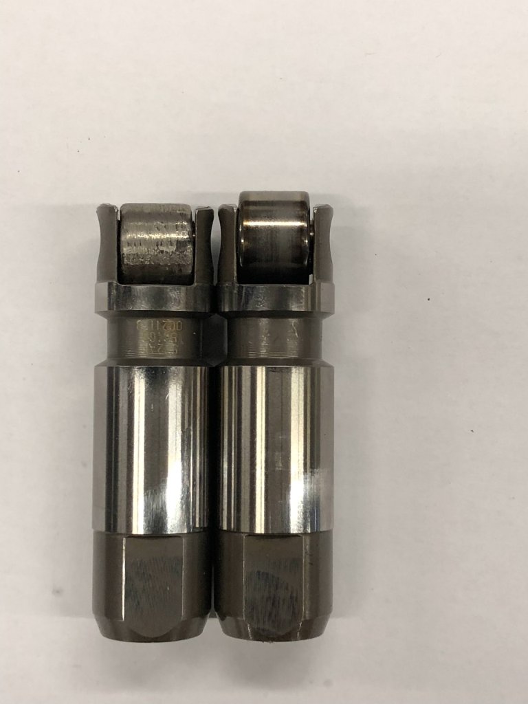

Found these two videos on ramforumz ( i see hemimann on there too) adding just cause, i'm sure people have seen them. Learning as i go here.
Lifter Comparison (Cut open)
Lifter Galley

They have pics rolling around, in 2016 the "needles" in the needle bearings are like twice as round as early version. This was an attempt at fixing hemi tick for sure, it was just never gonna work for most of hemi tick. That pic is good, you can see how the posts of the rollers end up causing the pits. It is mechanical for sure, not chemical. Those posts are never meant to touch the cam lob. There are also metallurgy reports rolling around the cam lobs are otherwise perfect.
Could be lash for sure, the weakness in ram forum's work has been lack of dyi mechanical fixes.
