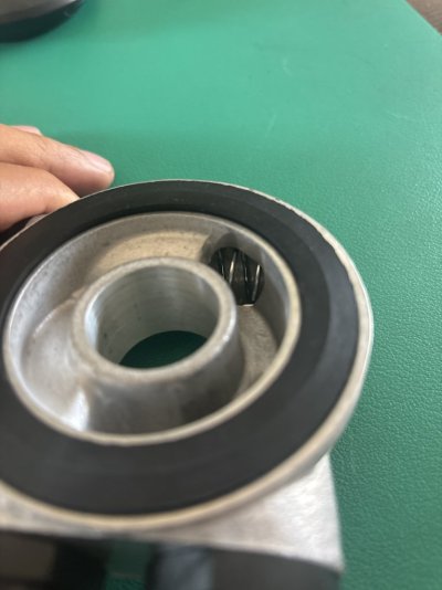

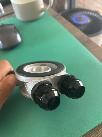

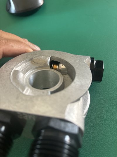

I guess I’ll see how much of a restriction this plate is… despite having m22 threaded ports, the orifice to get past the tstat isn’t comparable….

So I figured this was the gonna be the case but wanted to see for myself (stubborn).
With my current sandwich plate the larger filter won’t fit.
Setrab makes a remote thermostatic oil filter stand, seen here, but I haven’t seen any higher thermostat offering than 180°, plus I’d need another plate for the relocation ~$60, likely my lines I have are long enough, would need 4 more fittings.
So choice to be made.
Run the sammich plate I have with the 197° oil tstat and FE10060 filter, or, return it and get the Setrab one with 180° tstat and cough up a few more dollaridoos.
Ideally I want to keep the bigger filter and it would be nice to have it in a more convenient place…
I’ve sent Setrab a message asking if they make a ~200° tstat. We shall see what they say. If they do I’ll definitely go that route.
