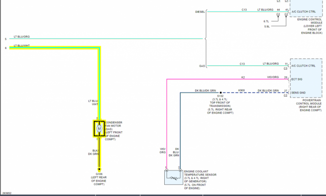

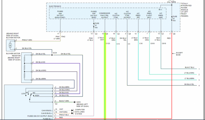

When AC is turned on the check engine light comes on.
Fault code is p0481 which is cooling circuit II.
I'm pretty sure the electric fan isn't coming on.
I switched the power window relay out with the fan relay and the power windows still work so I don't think it's the relay.
Any suggestions would be welcome.
