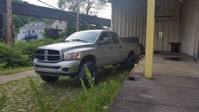

Few pics of my pride and joy to accompany my plee for help

Nice truck! Look for Bilstien shocks for your year truck. They're heavy duty, and provide a nice ride. They should be what you're looking for.
