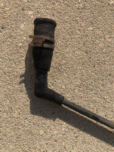

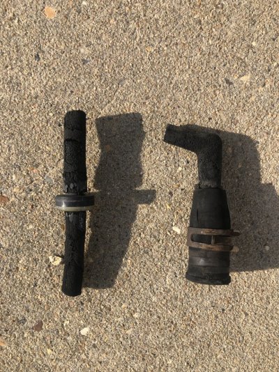

I have a 2002 Dodge Ram 2500 Diesel. Had issue with my AC only blowing up through my defrost. Turns out it was a vacuum issue.
Ordered a vacuum harness from my local dealership
Part #55056421AA for $22.35, took me 10 min. to swap out, fixed my issue.
